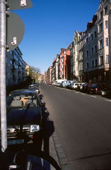

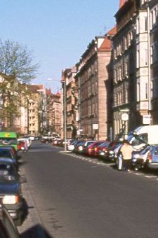

jaad75 - Nie 15 Cze, 2008
Cytat:
changing the focal length without changing the subject distance will not change perspective, as shown in the example below.
http://www.dpreview.com/l...spective_01.htm
Cytat:
Perspective depends only on your position. It has nothing to do with your lens.
Shorter or longer lenses don't change perspective, they just make framing tighter or looser.
Different lenses require you to move closer or farther way to get the framing you want, but it's the change in position that alters perspective, not the lens.
http://www.kenrockwell.co...rait-lenses.htm
Cytat:
Perspective has nothing to do with focal length. Perspective describes how a 3D scene is projected onto a 2D canvas, eg. film, digital sensor or even your retina. Perspective describes how the objects in the 3D scene appear in the 2D image, which objects are visible and which are obscured by other objects, how big they appear in relation to each other. Focal length only influences the field of view, ie. how much of the entire scene appears in the image. Focal length does not change the relative sizes of objects in the image. Perspective is only influenced by the relative position of the objects in the scene and by the position of the canvas (viewer, camera). If you want one object in the foreground appear much bigger than another object farther away, it doesn't help to change focal length. The only way to accomplish that is to get closer to the object in the foreground. If you want both to appear as being about the same size, the only way to accomplish that is to get farther away from both objects.
http://www.mhohner.de/essays/myths.php (Myth #8)
Może wystarczy?

[ Dodano: Nie 15 Cze, 2008 12:38 ]
dawid_ napisał/a:
Przedmioty fotografowane były ze zbyt dużej odległości i leżały zbyt blisko siebie, żeby zaobserwować zmianę perspektywy. Czarne tło też nie ułatwia oceny, ile tak naprawdę w nim się mieści.
To może 20mm i 100mm z kolejnego linka będzie dla ciebie bardziej przekonujące...
http://www.mhohner.de/images/tele1.jpg
http://www.mhohner.de/images/tele2.jpg
http://www.mhohner.de/images/tele3.jpg
/niestety, nie pozwalają na hotlinkowanie/
[ Dodano: Nie 15 Cze, 2008 12:43 ]
dawid_ napisał/a:
Co więc ma pozostać w tym samym miejscu? Napisz, a powtórzę test.
Płaszczyzna rzutowania, czyli w tym przypadku matryca.

Przeczytałem cały wątek i wiem o co chodzi z magicznie zmieniającą się perspektywą (nie chcę się wymądrzać, tylko akurat wiem o co chodzi ;) )
dawid_
1) Pierwsza strona: to są zdjęcia zeskanowane z katalogu Nikora sprzed paru lat ("Obiektywy Nikkor"). Oto cytat z tego artukułu:
Cytat:
Perspektywa
Perspektywa to zjawisko, które łatwiej wyjaśnić na przykładzie niż w teorii. Jest ona całkowicie określona przez odległość między aparatem i obiektem (patrz zdjęcia powyżej). Mówiąc w skrócie, perspektywa to względna wielkość i głębokość (czyli pozorna odległość między pierwszym planem i tłem) obiektów na zdjęciu. Jeśli obiekty na pierwszym planie wyglądają na znacznie większe od obiektów w tle - co ma miejsce w przypadku obiektywów szerokokątnych - nazywa się to przerysowaną perspektywą.
Poznanie różnych perspektyw oferowanych przez różne obiektywy pomoże wybrać odpowiedni obiektyw w celu uzyskania konkretnych efektów na zdjęciach.
2) Zmieniając ogniskową zmieniasz położenie płaszczyzn głównych obiektywu. To wywołuje przedstawiony efekt zmiany perspektywy. Wraz ze wzrostem ogniskowej płaszczyzny główne oddalają się od matrycy, więc należy cofnąć troszkę aparat. Efekt jest minimalny, jeżeli robisz testy w terenie a nie na stole, przy małych odległościach od fotografowanych przedmiotów. Jeżeli ktoś ma palącą potrzebę, mogę wytłumaczyć o co chodzi z płaszczyznami głównymi ale można też poszukać w Internecie. Generalnie są to teoretyczne powierzchnie, odwzorowane przez układ optyczny jedna w drugą z powiększeniem 1. Każdy układ optyczny da się przedstawić za pomocą dwóch takich płaszczyzn, dwóch ognisk oraz luk wejściowych i źrenic. To znacznie upraszcza sprawę i prowadzi do ciekawych konsekwencji. Np. światło, które "ulega załamaniu" zanim dotrze do obiektywu. Obiektyw o ogniskowej 1000mm nie musi mieć 1m długości, nieprawdaż? Optyka jest piękna :mrgreen:
W razie czego postaram się wytłumaczyć to bliżej ;]
