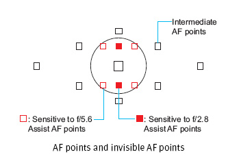

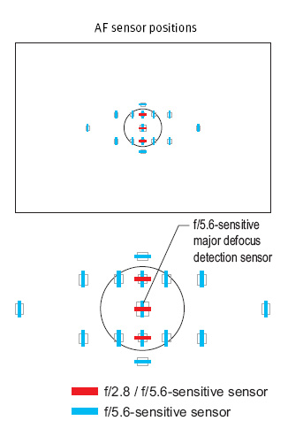

Cytat z dokumentu opisującego 5D, myślę że to powinno wyjaśnić temat:
Cytat:
The center AF point has a special hybrid design. With f/2.8 or faster lenses, focusing is a two-step process. First, the f/5.6-sensitive cross-type sensor components are used to focus. When focus is almost achieved, a switch is made to the f/2.8-sensitive vertical line-sensitive sensors for high-precision focusing. Additionally, the center AF point’s f/5.6-sensitive, horizontal line-sensitive sensors each have two lines with individual pixels arranged in a zigzag pattern, making a total of four lines for horizontal line-sensitive focusing at the center. With this improvement, the center AF point can now do a better job of detecting difficult-to-read, low-contrast subjects, thus improving the overall performance of the autofocusing system. All six Supplemental AF points are f/5.6- sensitive. The two Supplemental AF points directly above and below the center are also f/2.8-sensitive when a lens of f/2.8 or brighter is used.
Plik ściągnięto 16731 raz(y) 43,17 KB
Plik ściągnięto 16731 raz(y) 56,09 KB
